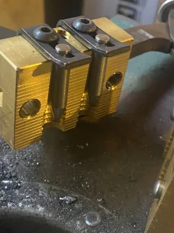

I used a couple of new-to-me mounds yesterday.
It’s a bit late since the owner is retiring and closing shop, but the NOE hollowpoint moulds are a joy to use. So much easier than the old HP pin-with-a-knob type.
They are a pain. I actually found it easier to build a jig and drill them out.
Do you have a pic of your new molds? They sound interesting.
I’ll have to take some pics. Basically, the HP pins are captive, each retained in a grooved bar. Open the mould, and the pin is free to move and wiggle around. Turning the mould upside down after opening is usually enough to make the bullets fall free.
He made these in two cavity and four cavity types.
The pins can be swapped for type. As far as I know, he always included HP pins, cup point pins to make a shallow dished cavity, and pins to make solid bullets.

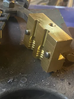

I took some pictures yesterday, but it was in a dark corner of the basement so they may not show things clearly.
When opened, the HP pins are free to slide out with the bullet and wiggle free from it. They go right back into place when closed.
He called these “RG” type, with a “2RG” at the end of the mould number in this case, meaning 2 cavity RG. He also made them in 4-cavity.
He calls it something different now, but the “RG” originally stood for “Rube Goldberg”. Despite that name, they work well.

That’s pretty ingenious. Has to be better than the knob and pin type. I guess I’ll have to keep my eye on the used market.
