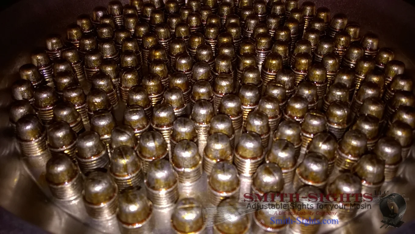

The Star is now sold by Magna. With the Star type, the sizing die is open all the way through. You drop a bullet into the die (it is tapered wider at the top so you can in fact drop it in) and lower the handle. The bullet passes through the sizing die, then at the bottom of this stroke the handle bumps a valve releasing the lube. Since the lube only comes out at this one point, you have to adjust that depth so the lube grooves line up with the holes for the lube. The top punch that pushes against the bullet gets screwed in or out to set this.
The next bullet to be sized pushes the previous bullet out and into a container.
With the Star, sometimes it works better to drop the bullets in nose-first and sometimes base-first. Location of the lube grooves on the bullet design might determine this. If you are seating gas checks while sizing, base-first is better.
The Star is by far faster. You drop a bullet in and work the handle. Drop and pull, drop and pull, and keep the lube pressurized by cranking its lever down now and then. You can get bullet feeders to keep a stack of bullets feeding in so you can just work the handle between bullet refills.
